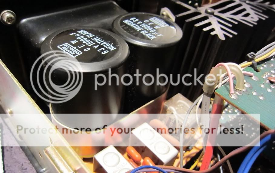

A pair of big 18000uf power supply filter caps:

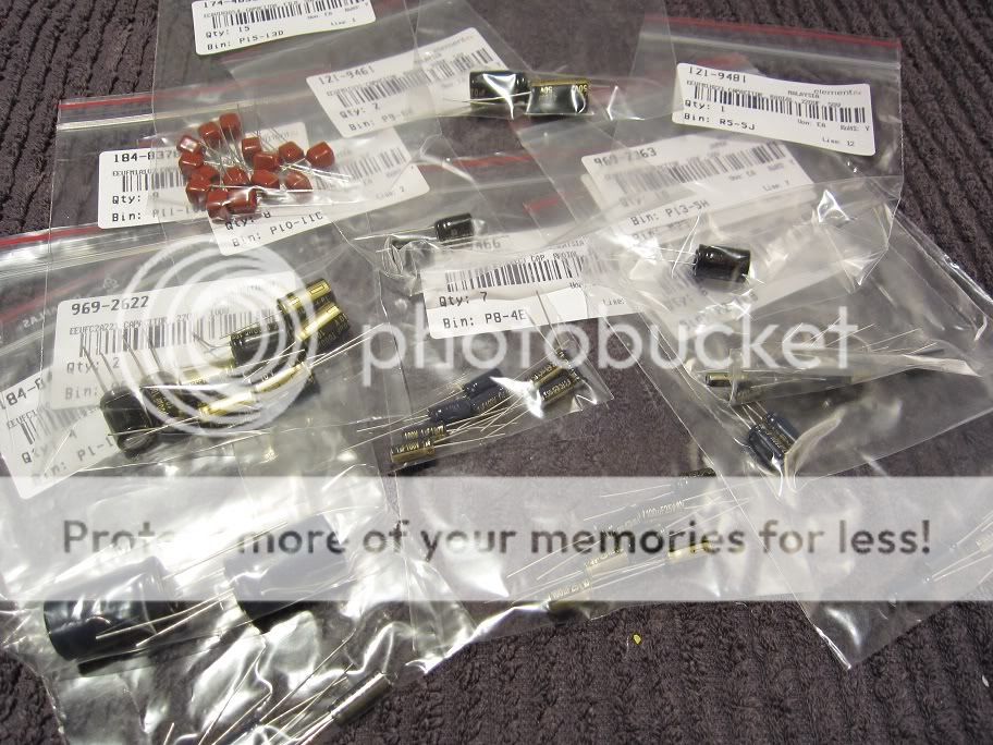

Some of the capacitors that will be going inside this sucker. Panasonic FC and FM caps, some Panasonic ECQ-V film caps, and also a bunch of Nichicon Muse ES bipolar caps and Nichicon Gold Tune 22000uf power suppply filter caps:
Note the size of the original caps vs the newer caps - in almost all cases the modern capacitors are smaller in size due to improved construction techniques and improved electrolyte:

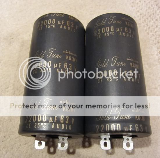

The lovely Nichicon Gold Tune caps are also now installed. The lugs on the caps required minor trimming to fit the PCB onto which they are mounted, but apart from judicious use of solderwick to remove the old solder (as well as me melting a bit of insulation on one of the orange wires... all fixed now though!) it was a fairly straight-forward job, albeit very time consuming! The fiddly stuff always takes far longer than anticipated, but of course the results are worth it. An AXON polypropylene bypass cap was installed across each of the filter caps for good measure.
Before:
After:
They sure are big suckers! Noticeably taller than the original capacitors.

I source the Nichicon Muse, Gold Tunes and Elna Silmics from partsconnexion. I haven't found a local supplier for these.
