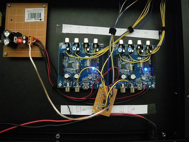

An op-amp and two resistors should do well ?
I use this with my MiniDSP
My equipments have dissapeared....

#5 gainphile
gainphile
    dip∞le
  • 1,563 posts
Posted 23 March 2012 - 08:17 PM
This is how it's done (that small brown board) :cool:
Btw. which MiniDSP do you have? The newer version has sensitivity jumper. Mine are the old ones.

chosen as they do look like pretty much a basic K.I.S.S. generic opamp buffer.
almost excessively described here, and for a few posts afterwards:
http://www.stereo.ne...971#entry518971
but the key changes:
-> bypass input coupling cap (as miniDSP no DC on output)
-> use socketed opa2134
-> didn't use tiny onboard power, but fed DC from chunky power supply I used for the miniDSP as well.
-> stepped attenuator volume controls so I can precisely match the gain on the 2 units.
.. then again I havent been using my miniDSP much recently although it sounds a bit clearer than my passive crossovers......
